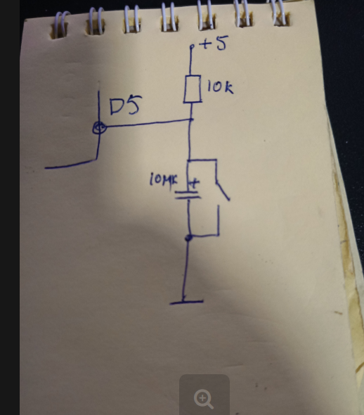

Jilber писал(а): Пн ноя 30, 2020 1:50 pm Просто напрямую на пин ? Можно кусок схемы ?
В скетче так:
bool switch_1_state = false;
unsigned long switch_1_delay;
const int switch_1_pin = D5;
const int switch_1_service = D6;
void ICACHE_RAM_ATTR switch_1() {
if (millis() - switch_1_delay > 300) {
switch_1_delay = millis();
switch_1_state = !switch_1_state;
void setup() {
pinMode(switch_1_pin, INPUT);
pinMode(switch_1_service, OUTPUT);
attachInterrupt(digitalPinToInterrupt(switch_1_pin), switch_1, CHANGE);
void loop() {
if(switch_1_state) {
digitalWrite(switch_1_service, HIGH);
} else {
digitalWrite(switch_1_service, LOW);
