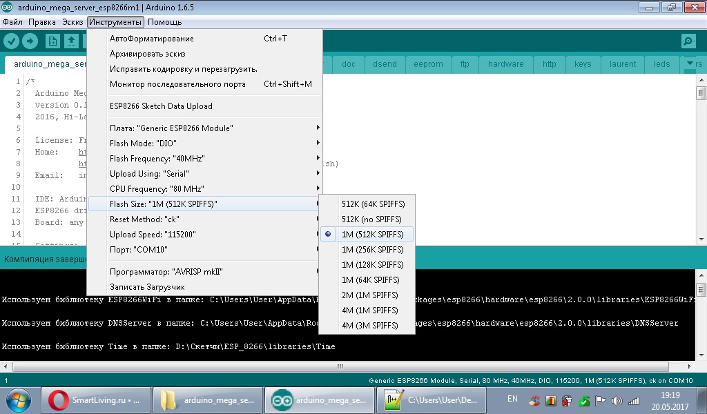

как его обуздать что бы залить в модуль ESP???
C:\Users\Ihor\Desktop\ams_esp8266m1_015\Sketches\Sketches\esp8266m1\Arduino\arduino_mega_server_esp8266m1\rtc.ino: In function 'void rtcInit()':
rtc:9: error: 'getNtpTime' was not declared in this scope
 setSyncProvider(getNtpTime);
rtc:9: error: 'setSyncProvider' was not declared in this scope
C:\Users\Ihor\Desktop\ams_esp8266m1_015\Sketches\Sketches\esp8266m1\Arduino\arduino_mega_server_esp8266m1\rtc.ino: In function 'void displayTime()':
rtc:15: error: 'now' was not declared in this scope
   uint16_t m = (now() / 60) % 60;
C:\Users\Ihor\Desktop\ams_esp8266m1_015\Sketches\Sketches\esp8266m1\Arduino\arduino_mega_server_esp8266m1\rtc.ino: In function 'void timeStamp()':
rtc:30: error: 'year' was not declared in this scope
   Serial.print(year());
rtc:32: error: 'month' was not declared in this scope
   printDigits(month());
rtc:34: error: 'day' was not declared in this scope
   printDigits(day());
rtc:36: error: 'hour' was not declared in this scope
   printDigits(hour());
rtc:38: error: 'minute' was not declared in this scope
   printDigits(minute());
rtc:40: error: 'second' was not declared in this scope
   printDigits(second());
C:\Users\Ihor\Desktop\ams_esp8266m1_015\Sketches\Sketches\esp8266m1\Arduino\arduino_mega_server_esp8266m1\server_ajax.ino: In function 'void parseRequest(WiFiClient)':
C:\Users\Ihor\Desktop\ams_esp8266m1_015\Sketches\Sketches\esp8266m1\Arduino\arduino_mega_server_esp8266m1\server_ajax.ino:87:37: warning: deprecated conversion from string constant to 'char*' [-Wwrite-strings]
   if (StrContains(HTTP_req, "GET / ") || StrContains(HTTP_req, "GET /index.htm")) {
C:\Users\Ihor\Desktop\ams_esp8266m1_015\Sketches\Sketches\esp8266m1\Arduino\arduino_mega_server_esp8266m1\server_ajax.ino:87:80: warning: deprecated conversion from string constant to 'char*' [-Wwrite-strings]
C:\Users\Ihor\Desktop\ams_esp8266m1_015\Sketches\Sketches\esp8266m1\Arduino\arduino_mega_server_esp8266m1\server_ajax.ino:100:41: warning: deprecated conversion from string constant to 'char*' [-Wwrite-strings]
   else if (StrContains(HTTP_req, "GET /") && StrContains(HTTP_req, ".htm")) {
C:\Users\Ihor\Desktop\ams_esp8266m1_015\Sketches\Sketches\esp8266m1\Arduino\arduino_mega_server_esp8266m1\server_ajax.ino:100:74: warning: deprecated conversion from string constant to 'char*' [-Wwrite-strings]
C:\Users\Ihor\Desktop\ams_esp8266m1_015\Sketches\Sketches\esp8266m1\Arduino\arduino_mega_server_esp8266m1\server_ajax.ino:107:41: warning: deprecated conversion from string constant to 'char*' [-Wwrite-strings]
   else if (StrContains(HTTP_req, "GET /") && StrContains(HTTP_req, ".css")) {
C:\Users\Ihor\Desktop\ams_esp8266m1_015\Sketches\Sketches\esp8266m1\Arduino\arduino_mega_server_esp8266m1\server_ajax.ino:107:74: warning: deprecated conversion from string constant to 'char*' [-Wwrite-strings]
C:\Users\Ihor\Desktop\ams_esp8266m1_015\Sketches\Sketches\esp8266m1\Arduino\arduino_mega_server_esp8266m1\server_ajax.ino:113:41: warning: deprecated conversion from string constant to 'char*' [-Wwrite-strings]
   else if (StrContains(HTTP_req, "GET /") && StrContains(HTTP_req, ".js")) {
C:\Users\Ihor\Desktop\ams_esp8266m1_015\Sketches\Sketches\esp8266m1\Arduino\arduino_mega_server_esp8266m1\server_ajax.ino:113:73: warning: deprecated conversion from string constant to 'char*' [-Wwrite-strings]
C:\Users\Ihor\Desktop\ams_esp8266m1_015\Sketches\Sketches\esp8266m1\Arduino\arduino_mega_server_esp8266m1\server_ajax.ino:119:41: warning: deprecated conversion from string constant to 'char*' [-Wwrite-strings]
   else if (StrContains(HTTP_req, "GET /") && StrContains(HTTP_req, ".pde")) {
C:\Users\Ihor\Desktop\ams_esp8266m1_015\Sketches\Sketches\esp8266m1\Arduino\arduino_mega_server_esp8266m1\server_ajax.ino:119:74: warning: deprecated conversion from string constant to 'char*' [-Wwrite-strings]
C:\Users\Ihor\Desktop\ams_esp8266m1_015\Sketches\Sketches\esp8266m1\Arduino\arduino_mega_server_esp8266m1\server_ajax.ino:125:41: warning: deprecated conversion from string constant to 'char*' [-Wwrite-strings]
   else if (StrContains(HTTP_req, "GET /") && (StrContains(HTTP_req, ".gif") ||
C:\Users\Ihor\Desktop\ams_esp8266m1_015\Sketches\Sketches\esp8266m1\Arduino\arduino_mega_server_esp8266m1\server_ajax.ino:125:75: warning: deprecated conversion from string constant to 'char*' [-Wwrite-strings]
C:\Users\Ihor\Desktop\ams_esp8266m1_015\Sketches\Sketches\esp8266m1\Arduino\arduino_mega_server_esp8266m1\server_ajax.ino:126:75: warning: deprecated conversion from string constant to 'char*' [-Wwrite-strings]
                                               StrContains(HTTP_req, ".jpg") ||
C:\Users\Ihor\Desktop\ams_esp8266m1_015\Sketches\Sketches\esp8266m1\Arduino\arduino_mega_server_esp8266m1\server_ajax.ino:127:75: warning: deprecated conversion from string constant to 'char*' [-Wwrite-strings]
                                               StrContains(HTTP_req, ".png"))) {
C:\Users\Ihor\Desktop\ams_esp8266m1_015\Sketches\Sketches\esp8266m1\Arduino\arduino_mega_server_esp8266m1\server_ajax.ino:135:51: warning: deprecated conversion from string constant to 'char*' [-Wwrite-strings]
   else if (StrContains(HTTP_req, "request_generic")) {
C:\Users\Ihor\Desktop\ams_esp8266m1_015\Sketches\Sketches\esp8266m1\Arduino\arduino_mega_server_esp8266m1\server_ajax.ino:140:51: warning: deprecated conversion from string constant to 'char*' [-Wwrite-strings]
   else if (StrContains(HTTP_req, "request_network")) {
C:\Users\Ihor\Desktop\ams_esp8266m1_015\Sketches\Sketches\esp8266m1\Arduino\arduino_mega_server_esp8266m1\server_ajax.ino:144:52: warning: deprecated conversion from string constant to 'char*' [-Wwrite-strings]
   else if (StrContains(HTTP_req, "request_settings")) {
C:\Users\Ihor\Desktop\ams_esp8266m1_015\Sketches\Sketches\esp8266m1\Arduino\arduino_mega_server_esp8266m1\server_ajax.ino:156:51: warning: deprecated conversion from string constant to 'char*' [-Wwrite-strings]
   else if (StrContains(HTTP_req, "request_control")) {
C:\Users\Ihor\Desktop\ams_esp8266m1_015\Sketches\Sketches\esp8266m1\Arduino\arduino_mega_server_esp8266m1\server_ajax.ino:170:50: warning: deprecated conversion from string constant to 'char*' [-Wwrite-strings]
   else if (StrContains(HTTP_req, "req_el_control")) {
C:\Users\Ihor\Desktop\ams_esp8266m1_015\Sketches\Sketches\esp8266m1\Arduino\arduino_mega_server_esp8266m1\server_ajax.ino:182:50: warning: deprecated conversion from string constant to 'char*' [-Wwrite-strings]
   else if (StrContains(HTTP_req, "request_sdcard")) {
C:\Users\Ihor\Desktop\ams_esp8266m1_015\Sketches\Sketches\esp8266m1\Arduino\arduino_mega_server_esp8266m1\server_ajax.ino:186:48: warning: deprecated conversion from string constant to 'char*' [-Wwrite-strings]
   else if (StrContains(HTTP_req, "request_dash")) {
C:\Users\Ihor\Desktop\ams_esp8266m1_015\Sketches\Sketches\esp8266m1\Arduino\arduino_mega_server_esp8266m1\server_ajax.ino: In function 'String makeTime()':

Для начала сказать в какую платформу заливаете, затем в какой среде компилируете.Ну и какой скетч. Экстрасенсы тут бывают,но очень редко )
Библиотеку Time не видит правильную. Остальное предупреждения.

Re: Проблема с запуском сервера
Сообщение batihor »
ESP8266-01.
Arduiono IDE 1.6.8
sketch: arduino_mega_server_esp8266m1
v0.15
Вот теперь сравните с версией IDE 1.6.5 и ответе себе на вопрос - Почему Вы используете версию 1.6.8 ? Вот лог компиляции 1.6.5 Модуля нет в наличии, загрузить не могу. Сначала заливаете файлы, затем скетч. Выбираете параметры как на картинке и будет Вам счастье !
Да. И версия дров для ЕСП 2.0.0 . В общем всё как написано на сайте. С точностью до миллиметра. Иначе --- .........будет вынос мозга..... И нам в том числе ))))
