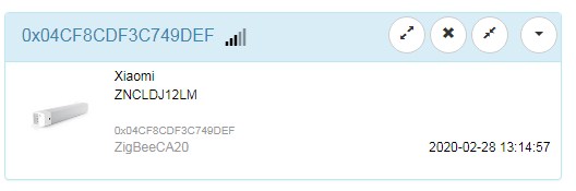

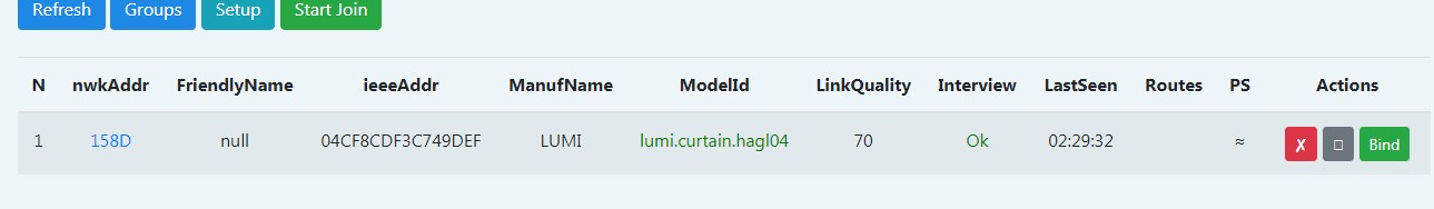

Шлюз не видит Livolo Wall switch? Что в логах , я не понимаю(Aven писал(а): Чт дек 12, 2019 10:31 pm Version: 20191212
+Поддержка для Livolo Wall switch (1 and 2 gang) & plug (TI0001)
[15:23:31.594] [MQTT] Send HB (202) {"Uptime":12728,"UptimeStr":"03:32:08","IP":"192.168.0.132","RSSI":"-61","Version":"2020.02.07d1","FreeMem":113628,"memoryUsage":1008,"LastRxTS":60,"LastTxTS":60,"log_level":"debug","permit_join":false}
[15:22:31.594] [MQTT] Send HB (200) {"Uptime":12668,"UptimeStr":"03:31:08","IP":"192.168.0.132","RSSI":"-51","Version":"2020.02.07d1","FreeMem":110340,"memoryUsage":1008,"LastRxTS":0,"LastTxTS":0,"log_level":"debug","permit_join":false}
[15:22:31.591] Joining disable
[15:22:31.590] [D] -- ReceiveCmd: 0x45B6 AREQ_ZDO_MGMT_PERMIT_JOIN_RSP, Len: 3, Data: 000000
[15:22:31.589] [D] WaitingForMessage Cmd: 0x45B6 AREQ_ZDO_MGMT_PERMIT_JOIN_RSP
[15:22:31.587] [D] -- ReceiveCmd: 0x6536 SRSP_ZDO_MGMT_PERMIT_JOIN_REQ, Len: 1, Data: 00
[15:22:31.574] [D] WaitingForMessage Cmd: 0x6536 SRSP_ZDO_MGMT_PERMIT_JOIN_REQ
[15:22:31.573] [D] -- SendCmd 0x2536 SREQ_ZDO_MGMT_PERMIT_JOIN_REQ, DataLen: 5, Data: 0FFCFF0000
[15:22:31.571] [D] WebZigBeeJoin Duration: 0
[15:22:23.907] [MQTT] Send HB (201) {"Uptime":12660,"UptimeStr":"03:31:00","IP":"192.168.0.132","RSSI":"-59","Version":"2020.02.07d1","FreeMem":113628,"memoryUsage":1008,"LastRxTS":60,"LastTxTS":60,"log_level":"debug","permit_join":true}
[15:21:39.321] SaveDevices()
[15:21:23.907] [MQTT] Send HB (199) {"Uptime":12600,"UptimeStr":"03:30:00","IP":"192.168.0.132","RSSI":"-58","Version":"2020.02.07d1","FreeMem":113568,"memoryUsage":1008,"LastRxTS":0,"LastTxTS":0,"log_level":"debug","permit_join":true}
[15:21:23.904] Joining enable
[15:21:23.903] [D] -- ReceiveCmd: 0x45B6 AREQ_ZDO_MGMT_PERMIT_JOIN_RSP, Len: 3, Data: 000000
[15:21:23.902] [D] WaitingForMessage Cmd: 0x45B6 AREQ_ZDO_MGMT_PERMIT_JOIN_RSP
[15:21:23.900] [D] -- ReceiveCmd: 0x6536 SRSP_ZDO_MGMT_PERMIT_JOIN_REQ, Len: 1, Data: 00
[15:21:23.888] [D] WaitingForMessage Cmd: 0x6536 SRSP_ZDO_MGMT_PERMIT_JOIN_REQ
[15:21:23.887] [D] -- SendCmd 0x2536 SREQ_ZDO_MGMT_PERMIT_JOIN_REQ, DataLen: 5, Data: 0FFCFFFF00
[15:20:48.381] [MQTT] Send HB (204) {"Uptime":12566,"UptimeStr":"03:29:26","IP":"192.168.0.132","RSSI":"-57","Version":"2020.02.07d1","FreeMem":113628,"memoryUsage":1008,"LastRxTS":600,"LastTxTS":600,"log_level":"debug","permit_join":false}
[15:19:48.380] [MQTT] Send HB (204) {"Uptime":12506,"UptimeStr":"03:28:26","IP":"192.168.0.132","RSSI":"-59","Version":"2020.02.07d1","FreeMem":113628,"memoryUsage":1008,"LastRxTS":540,"LastTxTS":540,"log_level":"debug","permit_join":false}
[15:18:48.379] [MQTT] Send HB (204) {"Uptime":12446,"UptimeStr":"03:27:26","IP":"192.168.0.132","RSSI":"-59","Version":"2020.02.07d1","FreeMem":113628,"memoryUsage":1008,"LastRxTS":480,"LastTxTS":480,"log_level":"debug","permit_join":false}
[15:17:48.378] [MQTT] Send HB (204)
- Screenshot_7.jpg (34.48 КБ) 7373 просмотра
- Screenshot_6.jpg (14.7 КБ) 7373 просмотра
- Сообщения: 2799
Re: SLS ZigBee Gateway
Ливоло вроде не умеет быть роутером. Если и умеет, я не рекомендовал надеяться на корректную маршрутизацию через них, так как прошивки для ливоло писали индусские школьники.Nail писал(а): Пт фев 28, 2020 2:45 pmШлюз не видит Livolo Wall switch? Что в логах , я не понимаю(Aven писал(а): Чт дек 12, 2019 10:31 pm Version: 20191212
+Поддержка для Livolo Wall switch (1 and 2 gang) & plug (TI0001)Хотя на нем висит мотор Агара но антенна ели ели, может не достает до выключателя через стены(4 метра)?Код: Выделить всё
[15:23:31.594] [MQTT] Send HB (202) {"Uptime":12728,"UptimeStr":"03:32:08","IP":"192.168.0.132","RSSI":"-61","Version":"2020.02.07d1","FreeMem":113628,"memoryUsage":1008,"LastRxTS":60,"LastTxTS":60,"log_level":"debug","permit_join":false} [15:22:31.594] [MQTT] Send HB (200) {"Uptime":12668,"UptimeStr":"03:31:08","IP":"192.168.0.132","RSSI":"-51","Version":"2020.02.07d1","FreeMem":110340,"memoryUsage":1008,"LastRxTS":0,"LastTxTS":0,"log_level":"debug","permit_join":false} [15:22:31.591] Joining disable [15:22:31.590] [D] -- ReceiveCmd: 0x45B6 AREQ_ZDO_MGMT_PERMIT_JOIN_RSP, Len: 3, Data: 000000 [15:22:31.589] [D] WaitingForMessage Cmd: 0x45B6 AREQ_ZDO_MGMT_PERMIT_JOIN_RSP [15:22:31.587] [D] -- ReceiveCmd: 0x6536 SRSP_ZDO_MGMT_PERMIT_JOIN_REQ, Len: 1, Data: 00 [15:22:31.574] [D] WaitingForMessage Cmd: 0x6536 SRSP_ZDO_MGMT_PERMIT_JOIN_REQ [15:22:31.573] [D] -- SendCmd 0x2536 SREQ_ZDO_MGMT_PERMIT_JOIN_REQ, DataLen: 5, Data: 0FFCFF0000 [15:22:31.571] [D] WebZigBeeJoin Duration: 0 [15:22:23.907] [MQTT] Send HB (201) {"Uptime":12660,"UptimeStr":"03:31:00","IP":"192.168.0.132","RSSI":"-59","Version":"2020.02.07d1","FreeMem":113628,"memoryUsage":1008,"LastRxTS":60,"LastTxTS":60,"log_level":"debug","permit_join":true} [15:21:39.321] SaveDevices() [15:21:23.907] [MQTT] Send HB (199) {"Uptime":12600,"UptimeStr":"03:30:00","IP":"192.168.0.132","RSSI":"-58","Version":"2020.02.07d1","FreeMem":113568,"memoryUsage":1008,"LastRxTS":0,"LastTxTS":0,"log_level":"debug","permit_join":true} [15:21:23.904] Joining enable [15:21:23.903] [D] -- ReceiveCmd: 0x45B6 AREQ_ZDO_MGMT_PERMIT_JOIN_RSP, Len: 3, Data: 000000 [15:21:23.902] [D] WaitingForMessage Cmd: 0x45B6 AREQ_ZDO_MGMT_PERMIT_JOIN_RSP [15:21:23.900] [D] -- ReceiveCmd: 0x6536 SRSP_ZDO_MGMT_PERMIT_JOIN_REQ, Len: 1, Data: 00 [15:21:23.888] [D] WaitingForMessage Cmd: 0x6536 SRSP_ZDO_MGMT_PERMIT_JOIN_REQ [15:21:23.887] [D] -- SendCmd 0x2536 SREQ_ZDO_MGMT_PERMIT_JOIN_REQ, DataLen: 5, Data: 0FFCFFFF00 [15:20:48.381] [MQTT] Send HB (204) {"Uptime":12566,"UptimeStr":"03:29:26","IP":"192.168.0.132","RSSI":"-57","Version":"2020.02.07d1","FreeMem":113628,"memoryUsage":1008,"LastRxTS":600,"LastTxTS":600,"log_level":"debug","permit_join":false} [15:19:48.380] [MQTT] Send HB (204) {"Uptime":12506,"UptimeStr":"03:28:26","IP":"192.168.0.132","RSSI":"-59","Version":"2020.02.07d1","FreeMem":113628,"memoryUsage":1008,"LastRxTS":540,"LastTxTS":540,"log_level":"debug","permit_join":false} [15:18:48.379] [MQTT] Send HB (204) {"Uptime":12446,"UptimeStr":"03:27:26","IP":"192.168.0.132","RSSI":"-59","Version":"2020.02.07d1","FreeMem":113628,"memoryUsage":1008,"LastRxTS":480,"LastTxTS":480,"log_level":"debug","permit_join":false} [15:17:48.378] [MQTT] Send HB (204)

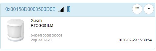

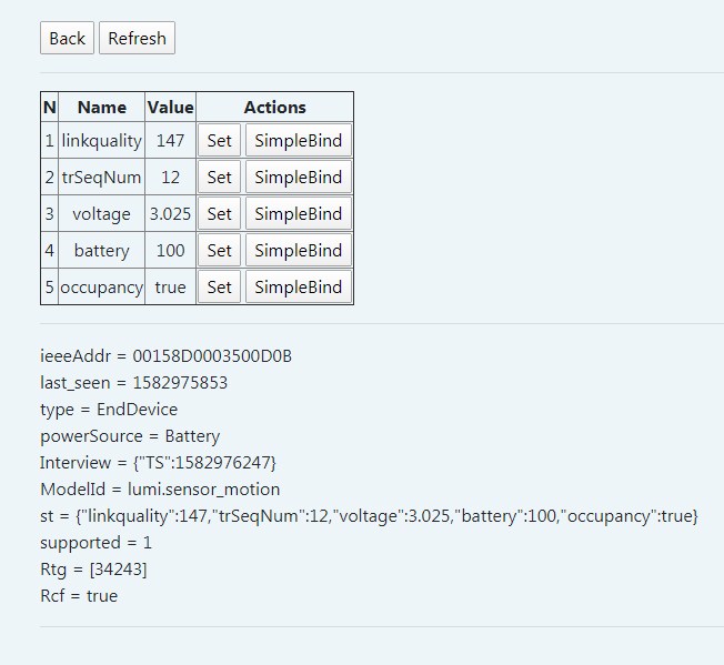

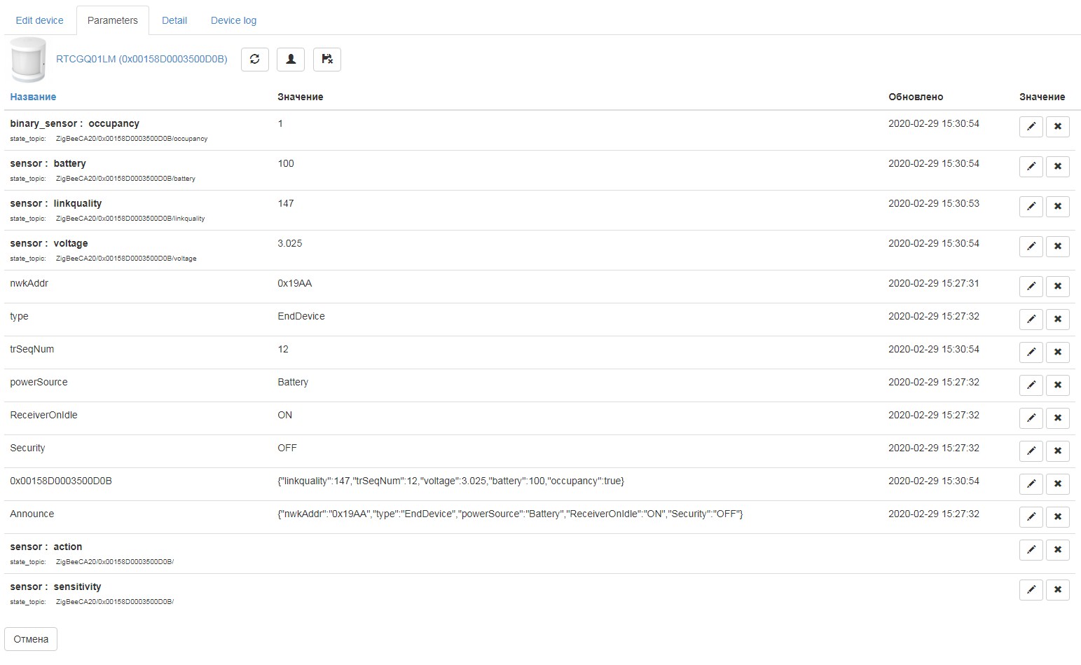

Датчик определился, но не реагирует? как встала binary_sensor : occupancy единица и все(
- Screenshot_9.jpg (60.26 КБ) 7278 просмотров
- Screenshot_7.jpg (13.71 КБ) 7279 просмотров
- Screenshot_6.jpg (155.64 КБ) 7279 просмотров
- Screenshot_3.jpg (15.04 КБ) 7279 просмотров
Re: SLS Zigbee Gateway
Все правильно, он не шлет false, только true не чаще раз в минуту (если движение продолжается)... если движения нет, то просто ничего не шлет... соответственно привяжите его к стандартному классу sMotions, и поставьте у объекта свойство timeout больше минуты, например 90, тогда после 1,5 минут после последнего зафиксированного движения ваш объект будет иметь 0 в статусе... Так работают все датчики движения что я видел не зависимо от протокола.Nail писал(а): Сб фев 29, 2020 2:36 pm Датчик определился, но не реагирует? как встала binary_sensor : occupancy единица и все(
Григорий собирался такой таймер прямо в SLS добавить для пользователей систем УД отличных от МД, но нам это не нужно, у нас есть SMotions...
И еще, судя по скринам вы модуль zigbee2mqtt используете, тут тоже может быть проблема, во первых в настройках топика не должна стоять галочка "посылать только новые значения", а во вторых даже если она не стоит модуль не шлет (или не всегда шлет неизменные значения), Дмитрию об этом неоднократно говорили, но пока это не поправлено... Если движения до объекта в МД не долетают, убедитесь что в SLS они есть (last seen) и тогда пока модуль zigbee2mqtt не поправлен,привяжитесь на прямую к топику без модуля...
