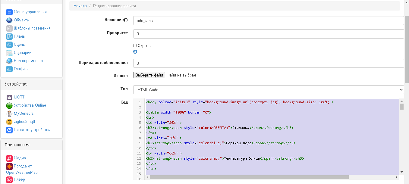

У меня одометры совместно с другими спидометрами. Код домашней страницы
<body onload="init()" style="background-image:url(concept2.jpg); background-size: 100%;">
<table width="100%" border="0">
<tr>
<td width="20%" >
<h3><strong><span style="color:MAGENTA;">Стиралка</span></strong></h3>
</td>
<td width="20%" >
<h3><strong><span style="color:blue;">Горячая вода</span></strong></h3>
</td>
<td width="60%" >
<h3><strong><span style="color:red;">Температура Улица</span></strong></h3>
</td>
</tr>
 <tr>
<td width="20%" >
<canvas id="canvasOdometer1" width="189" height="70"></canvas>
</td>
<td width="20%" >
<canvas id="canvasOdometer2" width="189" height="70"></canvas>
</td>
<td width="60%" >
<canvas id="canvasOdometer3" width="189" height="70"></canvas>
</td>
</tr>
<tr>
<td width="20%" >
<h3><strong><span style="color:MAGENTA;">Бак 1</span></strong></h3>
</td>
<td width="20%" >
<h3><strong><span style="color:MAGENTA;">Бак 2</span></strong></h3>
</td>
<td width="60%" >
<h3><strong><span style="color:red;">Кухня</span></strong></h3>
</td>
</tr>
 <tr>
<td width="20%" >
<canvas id="canvasRadial1" width="201" height="201"></canvas>
</td>
<td width="20%" >
<canvas id="canvasVertical1" width="201" height="201"></canvas>
</td>
<td width="60%" >
<canvas id="canvasVertical2" width="201" height="201"></canvas>
</td>
</tr>
</table>
<script>
    var odometer1, n = 999999997.7;
    var odometer2, n = 999999997.7;
	var odometer3, n = 999999997.7;
	var radial1;
    var  vertical1;
    var  vertical2;
    function init() {
	         // Define some sections
        var sections = [steelseries.Section(0, 25, 'rgba(0, 0, 220, 0.3)'),
                        steelseries.Section(25, 50, 'rgba(0, 220, 0, 0.3)'),
                        steelseries.Section(50, 75, 'rgba(220, 220, 0, 0.3)') ],
            // Define one area
            areas = [steelseries.Section(75, 100, 'rgba(220, 0, 0, 0.3)')],
            // Define value gradient for bargraph
            valGrad = new steelseries.gradientWrapper(  0,
                                                        100,
                                                        [ 0, 0.33, 0.66, 0.85, 1],
                                                        [ new steelseries.rgbaColor(0, 0, 200, 1),
                                                          new steelseries.rgbaColor(0, 200, 0, 1),
                                                          new steelseries.rgbaColor(200, 200, 0, 1),
                                                          new steelseries.rgbaColor(200, 0, 0, 1),
                                                          new steelseries.rgbaColor(200, 0, 0, 1) ]);
	        // Initialzing gauges
        radial1 = new steelseries.Radial('canvasRadial1', {
                            gaugeType: steelseries.GaugeType.TYPE1,
                            section: sections,
                            area: areas,
                            titleString: 'Title',
                            unitString: 'Type3',
                            threshold: 50,
                            lcdVisible: true
        vertical1 = new steelseries.RadialVertical('canvasVertical1', {
                            unitString: 'North',
        vertical2 = new steelseries.RadialVertical('canvasVertical2', {
                            unitString: 'West',
                            orientation: steelseries.Orientation.WEST
   odometer1 = new steelseries.Odometer('canvasOdometer1', {
 digits:6,
 decimals:1
        odometer2 = new steelseries.Odometer('canvasOdometer2', {
 digits:6,
 decimals:2
         odometer3 = new steelseries.Odometer('canvasOdometer3', {
 digits:6,
 decimals:2
        // Start the update
        //читаем данные каждые 2 с
		radial1.setFrameDesign(steelseries.FrameDesign.BLACK_METAL);
		vertical2.setFrameDesign(steelseries.FrameDesign.GOLD);
		vertical1.setFrameDesign(steelseries.FrameDesign.GLOSSY_METAL);
		radial1.setBackgroundColor(steelseries.BackgroundColor.STAINLESS);
		vertical1.setBackgroundColor(steelseries.BackgroundColor.BRUSHED_STAINLESS);
        setInterval(function(){ live_upd("/pChart/?op=value&p=mqttCounter05.value", odometer1); },2000);  // вставьте свое Объект.Свойство
		setInterval(function(){ live_upd("/pChart/?op=value&p=mqttCounter03.value", odometer2); },3000);  // вставьте свое Объект.Свойство
		setInterval(function(){ live_upd("/pChart/?op=value&p=ThisComputer.cycle_execsRun", odometer3); },4000);  // вставьте свое Объект.Свойство
	    setInterval(function(){ live_upd("/pChart/?op=value&p=MysensorsSensor_temp08.value", radial1); },2000);  // вставьте свое Объект.Свойство
		setInterval(function(){ live_upd("/pChart/?op=value&p=MysensorsSensor_temp09.value", vertical1); },3000);  // вставьте свое Объект.Свойство
		setInterval(function(){ live_upd("/pChart/?op=value&p=MysensorsSensor_temp01.value", vertical2); },4000);  // вставьте свое Объект.Свойство
    function live_upd(url,gauge) {
             $.ajax({
             url: url,
             }).done(function(data) {
              if (data!='') {gauge.setValueAnimated(parseFloat(data));}
</script>
<script src="../SteelSeries/steelseries.js"></script>
<script src="../SteelSeries/jquery.js"></script>
<script src="../SteelSeries/tween-min.js"></script>
<script src="../SteelSeries/steelseries-min.js"></script>
</body>
Конечно же библиотеки должны быть установлены заранее.
Создай домашнюю страницу с этим кодом

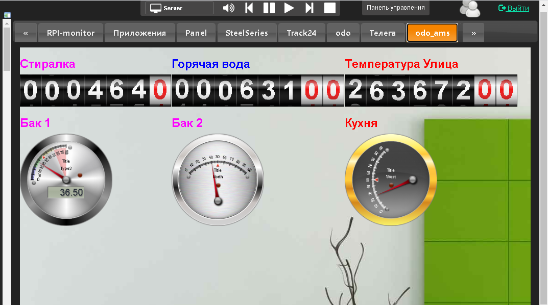

Выглядеть будет так
Скриншот 2020-10-09 20.17.44.png (187.31 КБ) 8432 просмотра
                            section: sections,
                            area: areas,
                            threshold: 50,
                            lcdVisible: true
                            unitString: 'West',
 digits:6,
 decimals:1
 digits:6,
 decimals:2
 digits:6,
 decimals:2
        // Start the update
             $.ajax({
             url: url,
</script>
</body>
Выглядеть будет так
