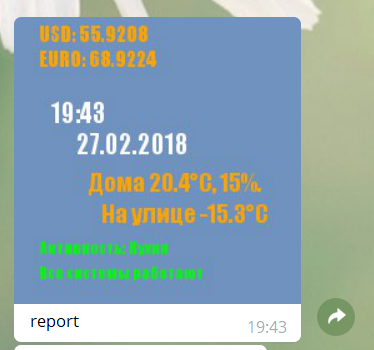

У m-malva было, только не онлайн
img_reportSPOILER_SHOW
//Картинка-информер для телеграмм
  define('WIDTH', 230);
  define('HEIGHT', 230);
  $font="./cms/font/impact.ttf";
  $image = imagecreatetruecolor(WIDTH,HEIGHT)
  or die('Cannot create image');
  $image = imageCreateFromPng("C:/_majordomo/htdocs/images/report.png");
  imagettftext($image,14,0,60,140,0xffa500,"$font","Дома ".getGlobal('ws.Tempinside').'°C, '.getGlobal('ws.relHumInside').'%.');
  imagettftext($image,14,0,70,165,0xffa500,"$font","На улице ".getGlobal('ws.tempoutside').'°C ');
 $alarmmsg=gg('ThisComputer.timeNow');
 $alarm="0";
 $alarmname=gg('ThisComputer.DateNow');
 $sizefont="16";
 $colorfont="0xFFFFFF";
 $WIDTHMSG="30";
 $HEIGHTMSG="85";
 $sizefont1="16";
 $colorfont1="0xFFFFFF";
 $WIDTHMSG1="50";
 $HEIGHTMSG1="110";
  imagettftext($image,$sizefont,0,$WIDTHMSG,$HEIGHTMSG,$colorfont,"$font",$alarmmsg);
  imagettftext($image,$sizefont1,0,$WIDTHMSG1,$HEIGHTMSG1,$colorfont,"$font",$alarmname);
$res='';
 if (gg('Security.stateColor')=='green' && gg('System.stateColor')=='green' && gg('Communication.stateColor')=='green') {
  $res='Все системы работают';
     $colorstat="0x00FF00";
 } else {
  if (gg('Security.stateColor')!='green') {
   $colorstat="0xff3030";
   $res.="Проблема безопасности: ".getGlobal('Security.stateDetails');
  if (gg('System.stateColor')!='green') {
   $res.="Системная проблема: ".getGlobal('System.stateDetails');
  if (gg('Communication.stateColor')!='green') {
   $res.=" Проблема связи: ".getGlobal('Communication.stateDetails');
$aa=0;
if ($aa == "0") $colortlevel="0x008b00";
if ($aa == "1") $colortlevel="0x008b00";
if ($aa == "2") $colortlevel="0xc0ff3e";
if ($aa == "3") $colortlevel="0xcaff70";
if ($aa == "4") $colortlevel="0xfff68f";
if ($aa == "5") $colortlevel="0xffff00";
if ($aa == "6") $colortlevel="0xff8247";
if ($aa == "7") $colortlevel="0xff3030";
if ($aa == "8") $colortlevel="0xcd2626";
if ($aa == "9") $colortlevel="0x8b1a1a";
if ($aa == "10") $colortlevel="0x8b1a1a";
    imagettftext($image,12,0,20,20,0xffa500,"$font",'USD: '.gg('usd.value'));
    imagettftext($image,12,0,20,40,0xffa500,"$font",'EURO: '.gg('eur.value'));
    //imagettftext($image,12,0,150,20,$colortlevel,"$font",'Пробки: '.$aa);
    imagettftext($image,10,0,20,190,$colorstat,"$font",gg('ThisComputer.somebodyHomeText'));
    imagettftext($image,10,0,20,210,$colorstat,"$font",$res);
  header('Content-type: image/png');
  imagepng($image,"C:/_majordomo/htdocs/cms/images/report.png");
  imagedestroy($image);
