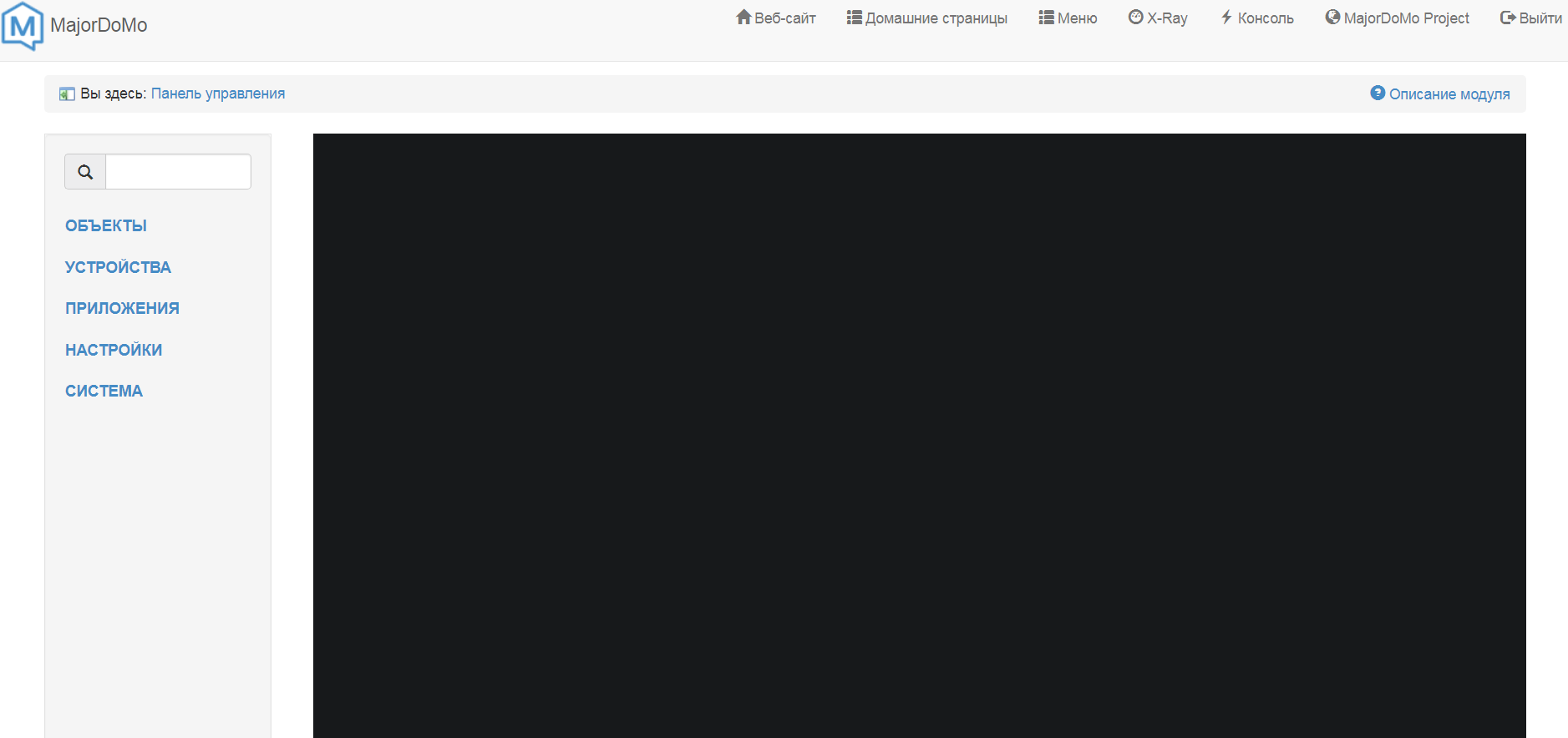

После последнего обновление не открываются пункт сцены ошибка 500 Apache2 в лог пишет следующее
[Wed Nov 22 18:11:13.222578 2017] [php7:error] [pid 6386] [client 10.65.68.61:64578] PHP Fatal error:  Uncaught Error: Using $this when not in object context in /var/www/lib/objects.class.php:1051\nStack trace:\n#0 /var/www/modules/scenes/scenes.class.php(1207): processTitle('[#module name="...')\n#1 /var/www/modules/scenes/scenes_search.inc.php(69): scenes->getElements('SCENE_ID='3' AN...', Array)\n#2 /var/www/modules/scenes/scenes.class.php(804): require('/var/www/module...')\n#3 /var/www/modules/scenes/scenes.class.php(303): scenes->search_scenes(Array)\n#4 /var/www/modules/scenes/scenes.class.php(100): scenes->admin(Array)\n#5 /var/www/lib/jTemplate.class.php(711) : eval()'d code(8): scenes->run()\n#6 /var/www/lib/jTemplate.class.php(711): eval()\n#7 /var/www/lib/jTemplate.class.php(195): jTemplate->parseModules('<!DOCTYPE html>...', Array, './templates/')\n#8 /var/www/lib/jTemplate.class.php(109): jTemplate->parse('<!DOCTYPE html>...', Array, './templates/')\n#9 /var/www/lib/parser.class.php(93): jTemplate->__construct('./templates/pan...', Array, Object(panel))\n#10 /var/www/lib/parser.class.php(63): parser->jtempla in /var/www/lib/objects.class.php on line 1051
[Wed Nov 22 18:11:13.664740 2017] [php7:error] [pid 6395] [client 10.65.68.61:64579] PHP Fatal error:  Uncaught Error: Using $this when not in object context in /var/www/lib/objects.class.php:1051\nStack trace:\n#0 /var/www/modules/scenes/scenes.class.php(1207): processTitle('[#module name="...')\n#1 /var/www/modules/scenes/scenes_search.inc.php(69): scenes->getElements('SCENE_ID='3' AN...', Array)\n#2 /var/www/modules/scenes/scenes.class.php(804): require('/var/www/module...')\n#3 /var/www/modules/scenes/scenes.class.php(303): scenes->search_scenes(Array)\n#4 /var/www/modules/scenes/scenes.class.php(100): scenes->admin(Array)\n#5 /var/www/lib/jTemplate.class.php(711) : eval()'d code(8): scenes->run()\n#6 /var/www/lib/jTemplate.class.php(711): eval()\n#7 /var/www/lib/jTemplate.class.php(195): jTemplate->parseModules('<!DOCTYPE html>...', Array, './templates/')\n#8 /var/www/lib/jTemplate.class.php(109): jTemplate->parse('<!DOCTYPE html>...', Array, './templates/')\n#9 /var/www/lib/parser.class.php(93): jTemplate->__construct('./templates/pan...', Array, Object(panel))\n#10 /var/www/lib/parser.class.php(63): parser->jtempla in /var/www/lib/objects.class.php on line 1051
