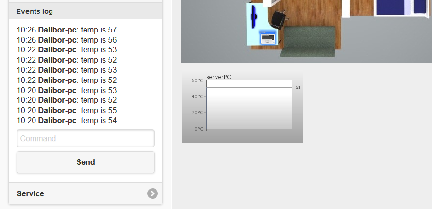

Also, even when I run the script manually every minute I do not get the graph to display history. I use this code for the graph
<img src="/pChart/?p=serverPC.temp&type=30m&width=280">
Type: HTML

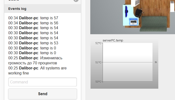

the graph always shows 51C +- 1C, like this
Temp Graph
Temp Graph
Skjermbilde 2015-11-15 00.44.13.png (82.37 КБ) 22681 просмотр
How to activate the graph? How to call the script every minute on most "correct" way? Any optimization to the setup above?

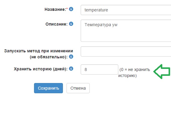

Set the properties of the class - save history.

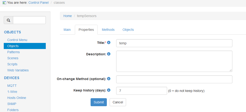

Than you for reply, it is already set to 7 by default on the master class

It looks better now, but still no history of the data.
Screenshot 2015-11-15 10.27.01.png (89.91 КБ) 22645 просмотров

I've changed type=8d to type=8h and now data appears nice (I also removed &scale=zero).
