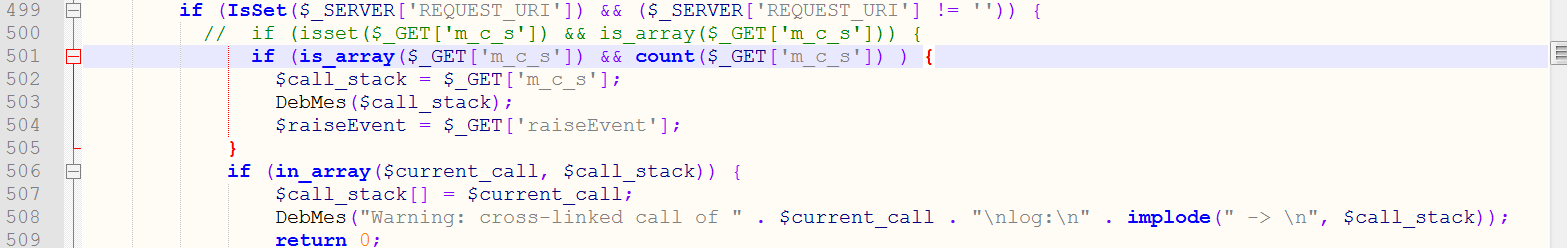

Slavik398 писал(а): Чт апр 09, 2020 1:25 pm
if (is_array($_GET['m_c_s']) && count($_GET['m_c_s']) ) {
Тогда еще такой вариант

tarasfrompir писал(а): Чт апр 09, 2020 1:42 pm
Заменил
Перезагрузил
Ничего не поменялось.
[Thu Apr 09 14:03:01.956627 2020] [php7:warn] [pid 5168:tid 1960] [client 127.0.0.1:54085] PHP Warning:  in_array() expects parameter 2 to be array, null given in D:\\xampp\\htdocs\\modules\\objects\\objects.class.php on line 506
[Thu Apr 09 14:03:02.019132 2020] [php7:warn] [pid 5168:tid 1960] [client 127.0.0.1:54085] PHP Warning:  in_array() expects parameter 2 to be array, null given in D:\\xampp\\htdocs\\modules\\objects\\objects.class.php on line 506
[Thu Apr 09 14:03:02.072519 2020] [php7:warn] [pid 5168:tid 1924] [client 127.0.0.1:54090] PHP Warning:  in_array() expects parameter 2 to be array, null given in D:\\xampp\\htdocs\\modules\\objects\\objects.class.php on line 506
[Thu Apr 09 14:03:02.135016 2020] [php7:warn] [pid 5168:tid 1924] [client 127.0.0.1:54090] PHP Warning:  in_array() expects parameter 2 to be array, null given in D:\\xampp\\htdocs\\modules\\objects\\objects.class.php on line 506
[Thu Apr 09 14:03:03.119130 2020] [php7:warn] [pid 5168:tid 1960] [client 192.168.8.108:45184] PHP Warning:  in_array() expects parameter 2 to be array, null given in D:\\xampp\\htdocs\\modules\\objects\\objects.class.php on line 506
[Thu Apr 09 14:03:03.237524 2020] [php7:warn] [pid 5168:tid 1960] [client 192.168.8.108:45184] PHP Warning:  in_array() expects parameter 2 to be array, null given in D:\\xampp\\htdocs\\modules\\objects\\objects.class.php on line 506
[Thu Apr 09 14:03:10.625385 2020] [php7:warn] [pid 5168:tid 1960] [client 192.168.8.104:19728] PHP Warning:  in_array() expects parameter 2 to be array, null given in D:\\xampp\\htdocs\\modules\\objects\\objects.class.php on line 506
[Thu Apr 09 14:03:20.529929 2020] [php7:warn] [pid 5168:tid 1924] [client 192.168.8.104:3894] PHP Warning:  in_array() expects parameter 2 to be array, null given in D:\\xampp\\htdocs\\modules\\objects\\objects.class.php on line 506

нашел чего не так - щас соображу
Re: Установка Мажордомо на XAMPP
замени всю функцию

tarasfrompir писал(а): Чт апр 09, 2020 2:24 pm замени всю функцию

Сейчас норм, в логе пусто,DebMes тоже ничего не выводит.
