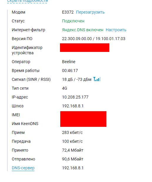

Amarok
Сообщения: 1434
Откуда: Россия, Нижняя Тура
Re: [Модуль] Keenetic (keenetic)
Сообщение Amarok »
include_once(DIR_MODULES . "keenetic/keenetic.class.php");
$keenetic_module = new keenetic();
$request = $keenetic_module->command('192.168.0.1', '{"show": {"interface": {}}}');
$interface = $request['show']['interface']['CdcEthernet0'];
$isp = $interface['operator'];
$signal_level = $interface['signal-level'];
$rssi = $interface['rssi'];
$net = $interface['mobile'];
$modem = $interface['ati']['manufacturer'].' '.$interface['ati']['model'];
$modem_hw = $interface['ati']['hardware'];
